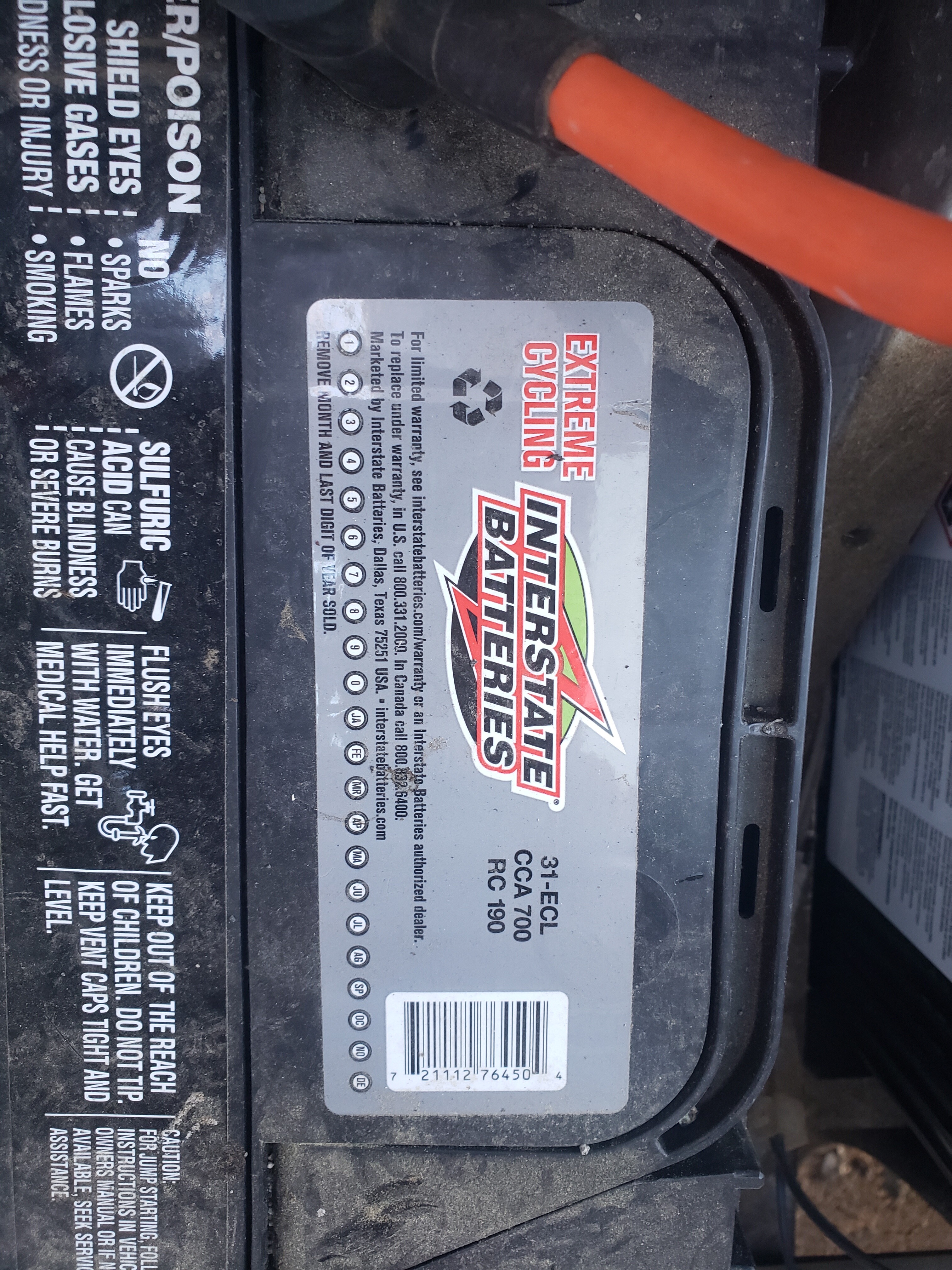

I just bought a 2002 GEM 825 that seller had new interstate batteries installed. The cart must not have the correct ‘profile’ programmed as it barely makes it 4-6 miles before error code -15.
Charge on batteries is high also. 16-20 volts at each of the 6 batteries (I’m wondering if my Fluke is wrong as it show 172V at the disconnect terminals!).
Obviously I’m a newby but attached is s picture of the batteries.
How do I program and correctly test the batteries (voltage and load). Also, there is s loose connector under the hood if anyone can tell me what it is?

Batteries- It sure sounds like you have one or more going bad. Charging to 15-20 will do that. You need to do a load test. Do a search and you will find several threads on how to do this but here is a real simple explanation from Old_Houseboater
Put your volt meter on 1 battery, hold your foot on the brake HARD and push the throttle for 2 seconds and note the voltage. Do all 6 batteries. The dud will show up.
You will need a working meter. Verify that yours is accurate or buy another.
Sure- the seller said the batteries were new, but can you find any big round date code stickers on them? (Taken off on purpose?) I see none of the little install circle tabs pulled off the label, but who really does that anyway? Last chance you might find a melted number pressed into the side. Sometimes you can figure out what that code is.
Unmarked, loose wires are the joys of second hand ownership.
Judging by the length, color, crimp terminal, and proximity of the Neg(-) batt terminal being right there, I’d say odds are good that it went on that post. Is that the last battery in the chain? It’s up to you to decide if you want to take the advice of Dirty Harry when he said, “Do you feel lucky, Punk?”
To fully understand the nature of the wire you might want to follow it back to it’s origin and discover it’s origin. It might be related to your charging issue, or an afterthought from a sloppy accessory install that introduces more problems with draining batteries when parked. It might have been unhooked for a reason.

I can’t tell from the photo, but the loose wire might have been the temperature sensor for the battery charger. It’s about the right diameter and that’s kind of typically to where they would reach to on the 00-04 years.
As mentioned, you’ll have to trace it to find out for certain.
