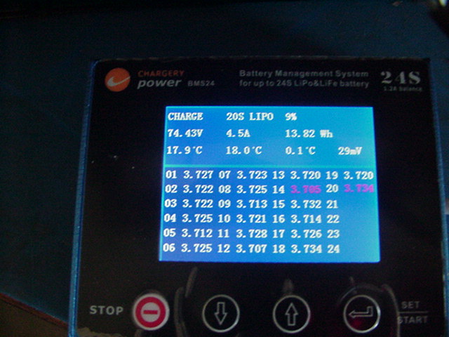

You’re thinking “that’s not right”! I’ll tell you what’s not right. Buying a new bms that’s not properly calibrated.
Not only is #18 not low. It’s high! ???
Here is a second brand new bms, right out of the box.

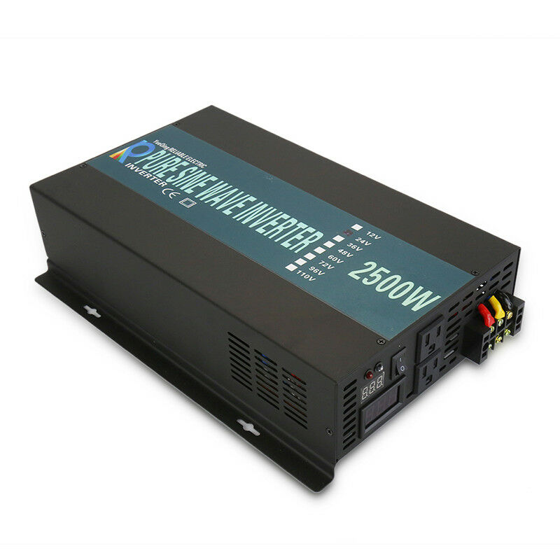

I did end up ordering an inverter like this one on eBay:
For the few other available 72 VDC options I looked at, I could find almost no information or reviews. This brand, “Reliable” seems to be a good quality option based on many reviews and videos of similar models.
There is a plethora of videos about their inverters and this one is a decent overview.
The eBay seller has been very responsive. He had me place the order on another listing (a little bit odd) with the correct price for my specifications that I messaged to him. It ended up at $305 because it was not US stock like some of their units and because I added a remote control option for $15.

What size are the lugs on the Battery pack? The inverter has 3/8" lugs according to Amazon Q&A.
