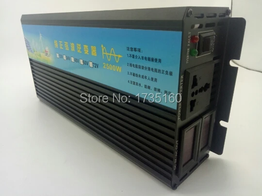

@Old_Houseboater I did switch from battery to battery as you described once during an outage when my 18kw standby generator would not start (bad fuel solenoid). I won’t be doing any more of that with the new lithium pack. The problem with the 72VDC inverter is (was?) Lack of options at a reasonable price. The smaller needed boost from 72VDC to 110VAC means higher efficiency and in theory less heat less voltage sag. I plan to use it for tools such as brushless electric pressure washer, PA speakers (thinking parade use), emergency backup power source for me or neighbors, camping, etc.
72v to 120vac are not commonly stocked. This one I’m looking at.
