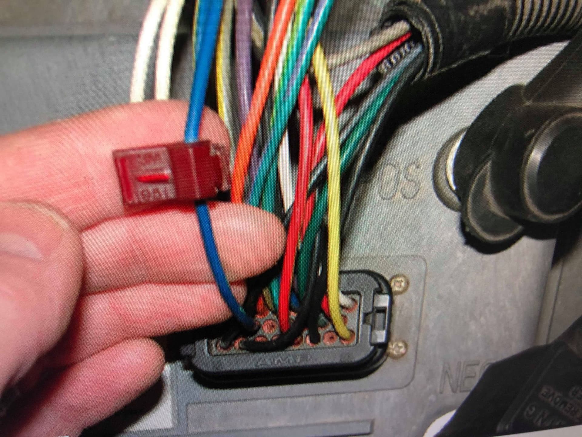

Cut the wire method
Up front under your hood is your motor controller. It is a gray box with a couple of large cables going to it, and also a bundle of small wires in a harness.
Orient yourself to this plug and seek out wire 10. It should be Blue with a Green stripe.
Cut the wire with enough distance from the main plug so it can be reconnected later by the next guy.
Tape the loose ends into the bundle so they are protected from the elements.
Enjoy your new ability to back down the driveway in silence.
