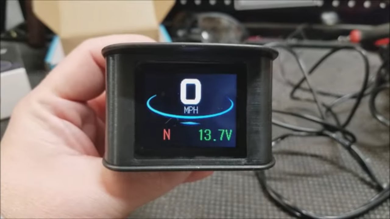

Completed installation of customized steering column mounted GPS speedo from SpeedHut w/ 3D printed housing. Roof bar holds GPS antenna. Works great!

I opted for the 50MPH unit and chose the customized GEM logo for +$20. They will work w/o the GPS antenna - but since I was installing the light bar I went ahead and incorporated it into the bar.
I also connected the optional hot wire that connects to the positive post of the auxiliary 12v battery. It draws just milliamps and remembers the last SAT positions eliminating any time delay in acquiring their locations.
I’m very satisfied with the unit!
I see it has a Digital screen @ the Bottom and a toggle button just like the stock speedo what info can you scroll threw? What info can be displayed
The following menu features are available with the speedo.
After considering the cheaper GPS speedo alternatives, I felt the USA manufactured unit with a lifetime circuit board warranty was worth the extra investment.

I like some of the options like Elevation feature. So what’s the deal with the 3D printed mount. How could I get my hands on one?
I’d be happy to send you the 3D .stl file I created. It will take a little post Dremel tool application – but fits rather well over the 2020 steering column.
Due to the length of the GPS antenna port sticking out the rear of the speedo, I had to create an additional pocket to allow the speedo to swivel with a 90 degree SMA adapter (https://www.amazon.com/Female-90-Degree-Adapter-Plated-Contacts/dp/B00VHAZ0KW/ref=asc_df_B00VHAZ0KW/?tag=hyprod-20&linkCode=df0&hvadid=226131567976&hvpos=&hvnetw=g&hvrand=4999355835378308612&hvpone=&hvptwo=&hvqmt=&hvdev=c&hvdvcmdl=&hvlocint=&hvlocphy=9029717&hvtargid=pla-390921815706&psc=1)
