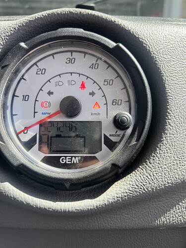

Changed the battery on under the dash, it’ll only move about 10ft then acts dead (possibly pulling power from the 12v???)
Dash reads low battery and blinks an empty battery.
SOC 0%

Is this the only thing the display is showing?
-or-
Is the display cycling through a few different numbers?
With your handheld meter, Measure battery and check if the battery is increasing Voltage.
Is your dash showing anything different?

Still says battery low and SOC 0%
