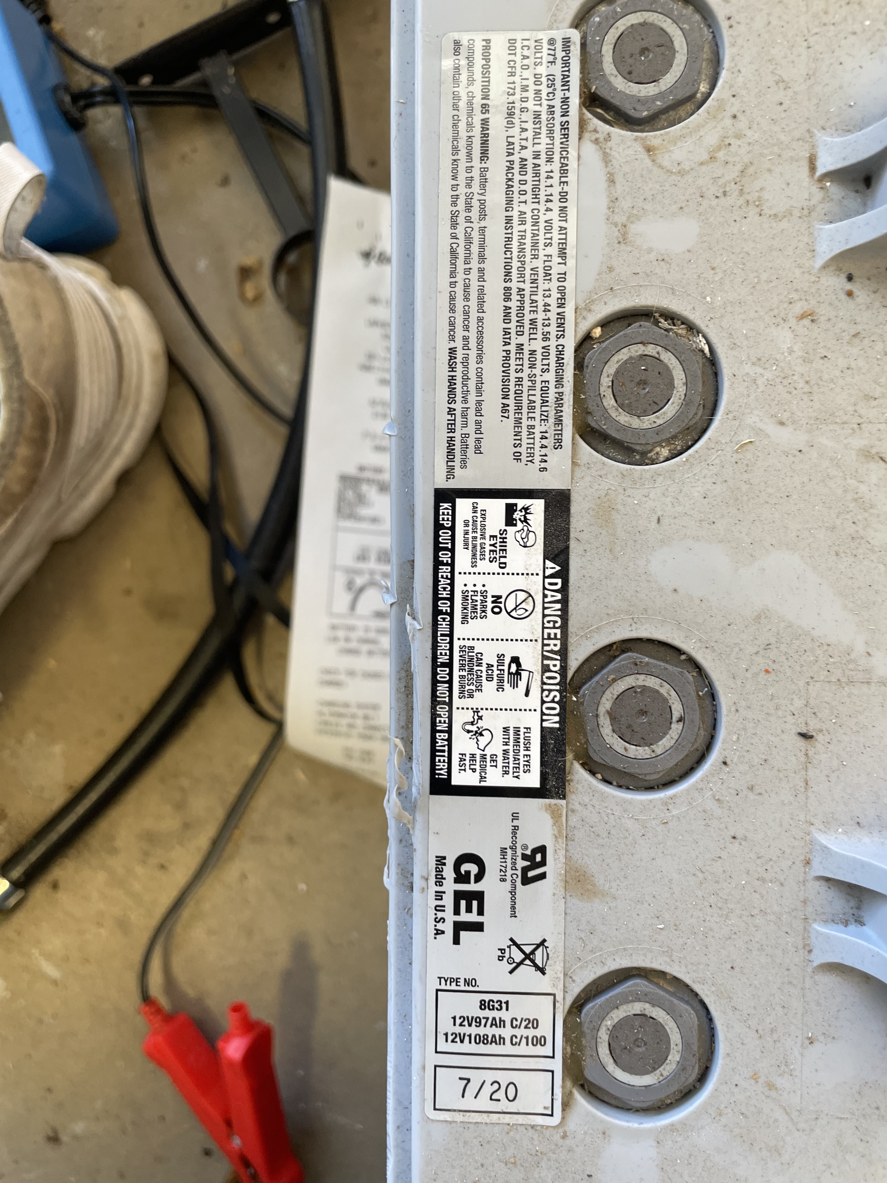

Batteries
I used a ford battery tester to test my batteries, my tech told me that deep cycle typically dont have a CCA so i lowered it to the lowest setting. These are the bateries i have. Im going to buy a load tester today and retest. These are the batteries i have

Also, is there a specific load tester i should buy to get the most accurate results not sure if they are specific to deep cycle batteries or not.
thanks again
I just confirmed with DEKA that the batteries have a 450 CCA. so judging by the readouts the batteries should be good but i will retest them this evening with the correct cca setting.

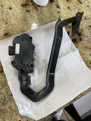

I think it might be about time to send you a replacement pedal.
Was thinking the same RFF will rebuild for $450. Ill prob tear it down tom an hopefully overnight it friday! Thank you for all of your help, if you have any recommendations for settings in sentry programmer for 7.5 hp rff motor with their upgraded wheels i do know how to modify settings on controller. Thank u for all of your help!
Same errors, btw all hooked up.
Not Controller -
Pedal first. Let me send you a pedal to try.
R4F sends their controllers to Flight Systems.
Sounds good, 2 things … how much? and i dont have paypal or venmo. which is why i was going to go through them bc i can do it on their website and i got my motor rims and tires from them.
