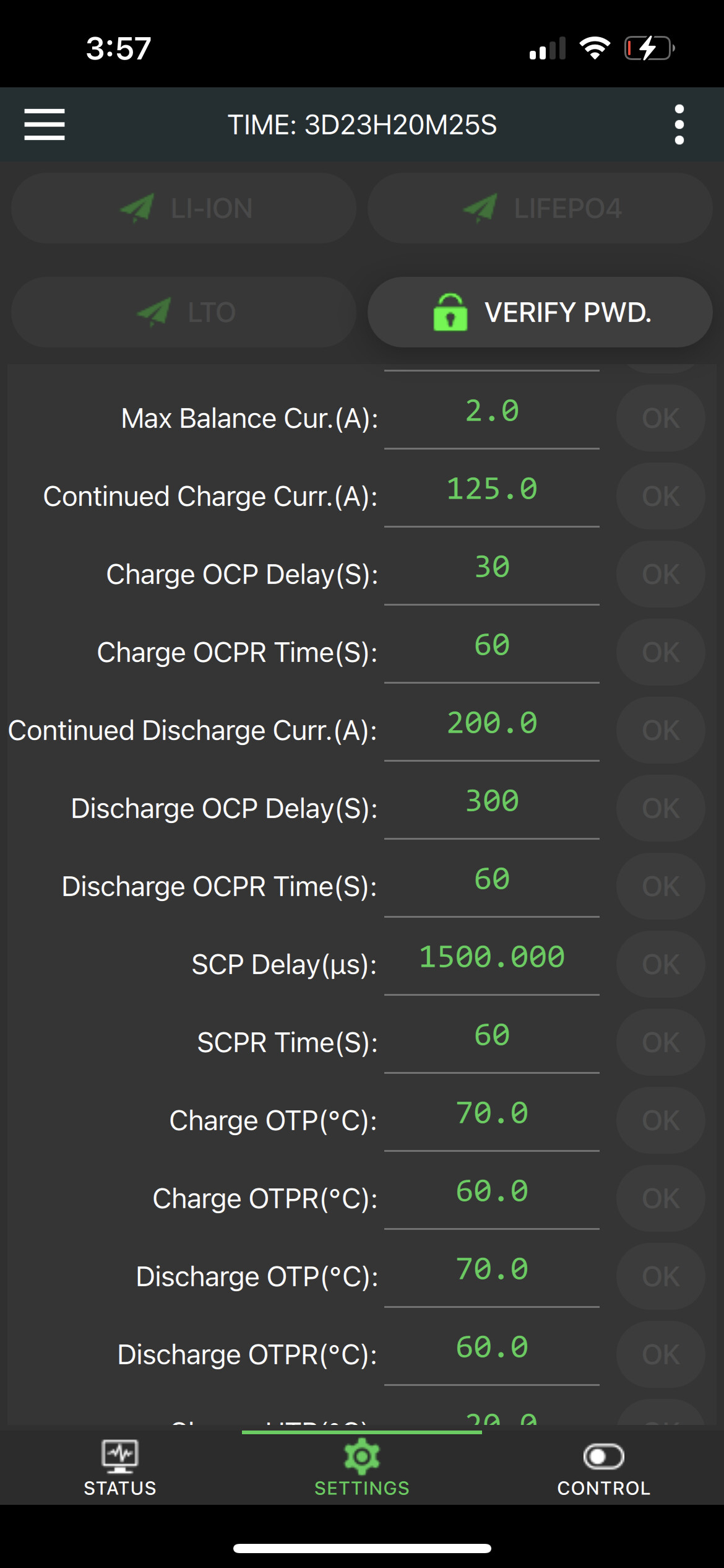

I bought a Samsung lithium pack from Dave. I’ve got all the way up to the point of turning on discharge in control tab. Problem is it isn’t showing up in status…still shows off. Any suggestions as to what I’m doing wrong?

Maybe I missed something in settings.
Look at cell= 22 and capacity=94.
I missed that in one yesterday.
Totally my mistake.
Post screen shot of Settings tab.
Click on advanced (just the first two pages)
Then click on that yellow warning message that says Click to View All Warning Messages.

Then maybe shut down the app in your phone and restart the app.

I got it running. Balance is still showing off, is this correct?
Is the first cell supposed to show red?
When you say keep V over 3.55 you mean avg cell V?
Thanks,
Jeff
Bal will change status on its own as it watches cells. Ok that it appears off at this time.
Only balances when needed. It’s fine.
Colored cell are high and low. Normal.
Average or single cell. Not much difference. Only rule of thumb so you don’t get stranded…
Reason to set ovp low at this time, Car won’t start over 86v.
We can move it up to 4.1v for more range.
