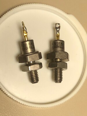

Not common but they can be found. This should handle 1 amp.

Forgot to get back to you on this, but when we put the two spoofs you sent in series, then the cart worked perfectly.
Think the old spoof must have gone bad for some reason, and the two new sppofs you sent were the wrong coltage individually, but fine when in series. Really glad you thought of that, because I would never have thought to try them in series.

What voltage do you need?
I actually have no idea.
Cart is 28 cell LifePo, so think that is 96 volts. Believe you were originally meant to send 2 spoofs at 15v, but I think by mistake you sent 2 spoofs at 7.5 volts? Could be wrong on the spoof voltage numbers, but per your suggestion, when they were put in series they acted as one spoof that worked.
Stewart
What is charger set to? If it’s a 72v DQ, then 15v is the highest needed.
I would have sent 2 x 7.5v. You can measure the voltage across them to know.
It is a DQ charger so 15 sounds right based on that.
Also this is what you sent that had me put them in series, so guessing you sent two 7.5 instead of two 15:
“I think that I sent 7.5v spoofs. Connect both in series for 15v.
Measure on controller side of spoof. <85v car should run.”
Cart runs, so think you were right :slight_smile:
