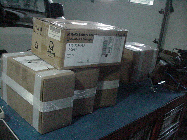

I see the batteries are in route and should be here on Thursday - so excited to get this up and going!
Two stupid questions - (i) are there any special instructions / best practices for installation of the lithium cells that I should be aware of etc?, and (ii) is it possible to have the existing battery/power monitor in the dash work with this set-up to have an idea of how much charge is left when I am out and about?

David,
Batteries arrived, as did the charger - so wanted to let you know. Believe you were sending the spoof separately, so will keep my eye out for that.
On installation - anything to watch out for etc, or is this as simple as replacing the existing? You mentioned adding a cheap monitor to the dash rather than using the factory installed one - any specific monitor you would suggest?
