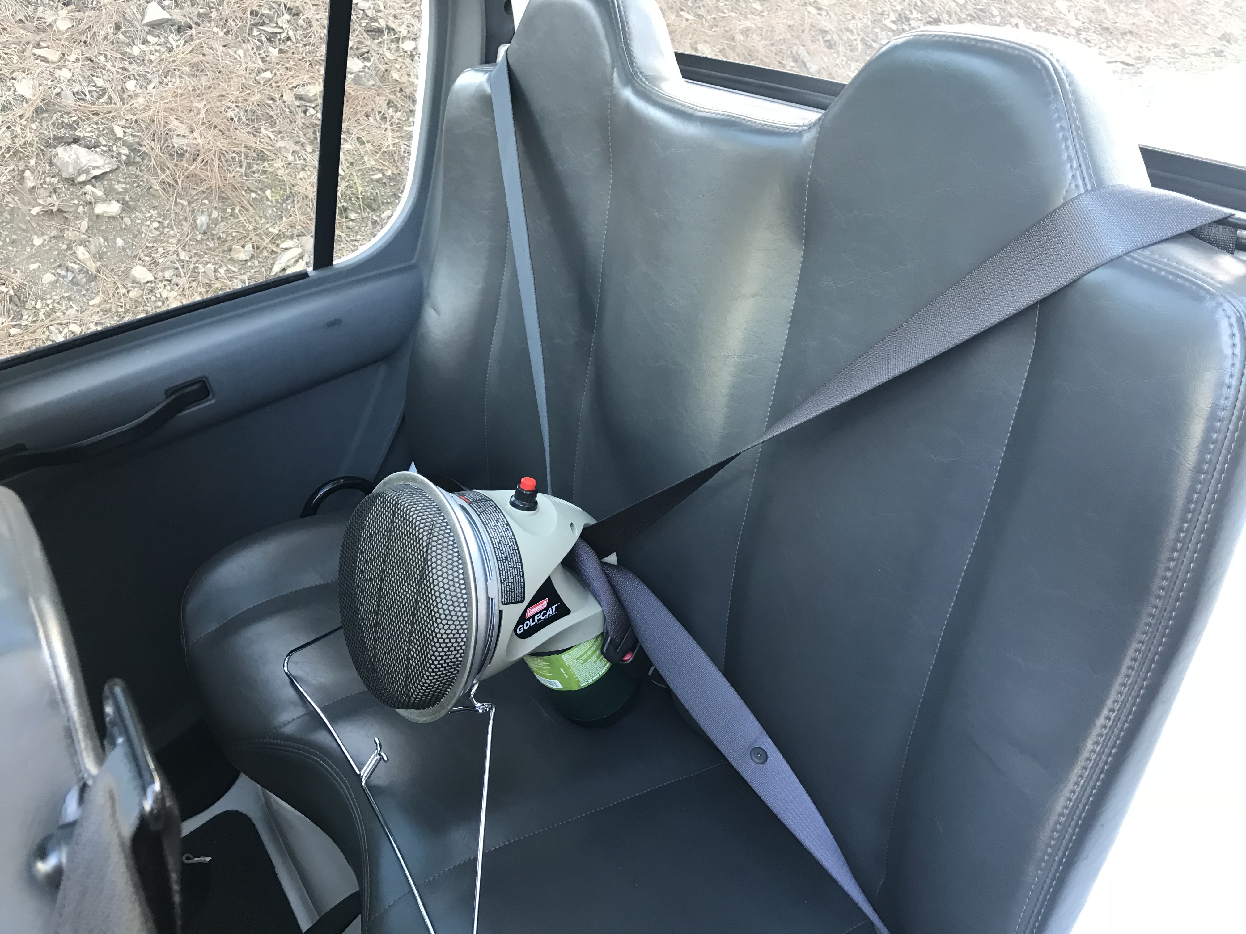

Don’t waste range on a heater. These cataletic heaters (safe for indoor use) work great heates the Gem better then any electric heater and dosent impact range
