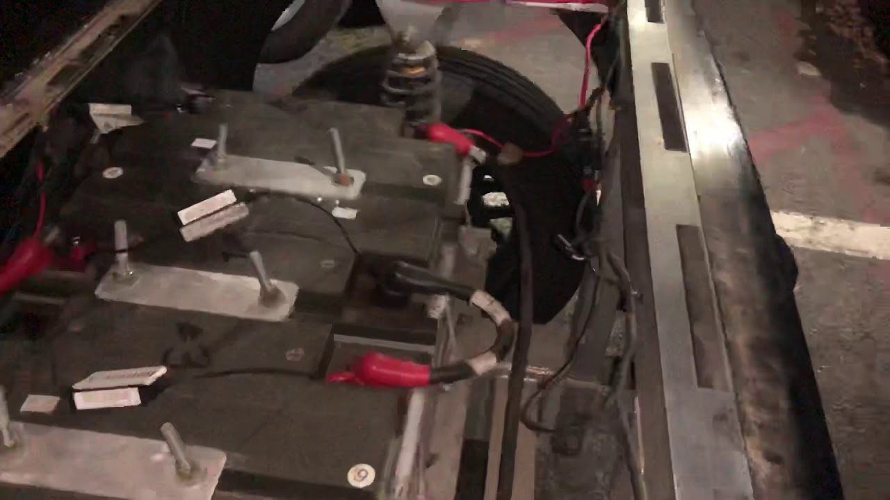

Is the red wire by battery #1 positive, (pos 4) disconnected? One or both ends?
I think this video might give a better perspective.
I see it’s still connected to the battery. If it’s connected at the front, the recall was not done correctly.
A relay is added to keep aux. battery charged, but the the 12v tap on the main pack must be disconnected.

Maybe this will help clarify my question.
This is the wire that is over charging battery #1.
It is used to power constant 12v systems when there is no auxiliary battery.
The added battery is kept charged with dc-dc converter by adding a relay. The red wire must be cut to isolate the new battery from battery #1.

Yes, as you point out, the thin red wire is definitely still connected to the positive battery terminal of battery 1 (position 4). You say that if this isn’t disconnected where you circled it in your photo, they didn’t perform the recall service properly??
So I just disconnect the Battery Ring Terminal of the thin red wire where you have it circled on Battery 1 (Position 4)?? I should wrap it in electrical tape and zip tie it off?? Additionally, you specified that it should be disonnected from the front of the GEM Car as well?? Both ends of this thin red wire need to be disconnected? You say it goes directly to the new AUX battery under the front dash?

An auxiliary battery was added which is charged by the dc-dc converter when key is on.
As the added battery feeds the same “always on” circuits as the 12v tap did previous, the red wire from tap needs to be disconnected. If it remains connected, the dc-dc will also charge battery #1.
Somewhere I read to disconnect both ends and tape them up.
One end should be just as effective in isolating the first battery in string from and loads or circuits.
If auxiliary battery goes dead, something else was not updated properly.
