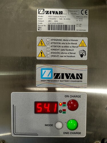

I found out I needed to charge my battery all the way to get it out of Sleep. My question now is, is there a way to get the original Zivan charger to put out 58.4v? It seems like it is not putting out enough voltage to charge. I have a Litime 58.4v charger here but I would really like to use the factory charger if possible.
I think it depends on what kind of battery you’re replacing. My GEM has similar battery which replaced an AGM distance pack. That profile on my delta Q puts out the voltage needed to charge the lithium battery. I’m not familiar with ZIVAN chargers but I imagine the BMS in your GEM is telling it what to do so your BMS would need to be flashed to AGM distance pack.
I had the AGM distance pack in mine as well. It looks like this Zivan is only putting out 54v. Maybe someone knows how to reprogram them?

I have not used it with the Zivan charger, but only needs 50 volts for full charge.
Test car got 60 mile range from 10kwh battery.
Zivan is can bus control, not programmed. Iirc

I can reprogram the zivan, to make it charge it up till the voltage you want but it’s not gonna fix the other issues.

Just wondering. Does your charger stay at 54 volts for the entire charging cycle?
Mine starts out in low 50s but eventually gets up to 56 or 57 near the end of the cycle.
I didn’t leave it plugged in for more than 15min to try it. I could try longer and see what happens.
If you replaced an AGM distance pack, it should get up to just above mid 50s and charge your battery to 100%. I assume you got a monitor for your lithium battery. You should be able to watch the monitor and see what’s going on. The battery monitor will not match your dash display. Trust the battery monitor. You should get about 40 miles out of 100 Ah. Hard acceleration will test 200amp BMS. 2 of those batteries in parallel will get you about 80 mile range and reduce amps on the battery BMS.
I really appreciate all your input, my battery does have Bluetooth and I was watching but it never goes to charging when I have the factory charger plugged in.
