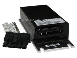

Found the same sevcon style dc dc converter but capable to go up to 120v
Here the specs
its almost plug and play. There’s an easy mod that needs to be done (jump the 4th and 5th pin) to make it work.

I do have a 12v battery, the 5th pin is “enable”   I jumped it to  +in
The original dc dc has 4 pins, the gem cuts the input power when the ignition is turned OFF.
In this case it works the same way. With the 5t pin jumped
Don’t buy them if they are the part 00010011. I’ve read that Polaris replaced them because they used to catch on fire.
I can give you the name of the guy I bought it from.
You will need the 5 pin connector too
These are not Gem parts. Sevcon 622711202.

$75 without plug.
“Can be used to charge a battery” ![]()
It should work, Mine is 500w, I know you like the plug and play things, find a female and make a harness from 4 to 5 pin.
Yea it charges the battery (13.8 when ignition is ON)

the 5th pin will turn ON the converter if connected it to B+. In that case It will be always ON like the Dci always on Not sure what’s the dci idle consumption, this is 85mA it should be similar IMO.
