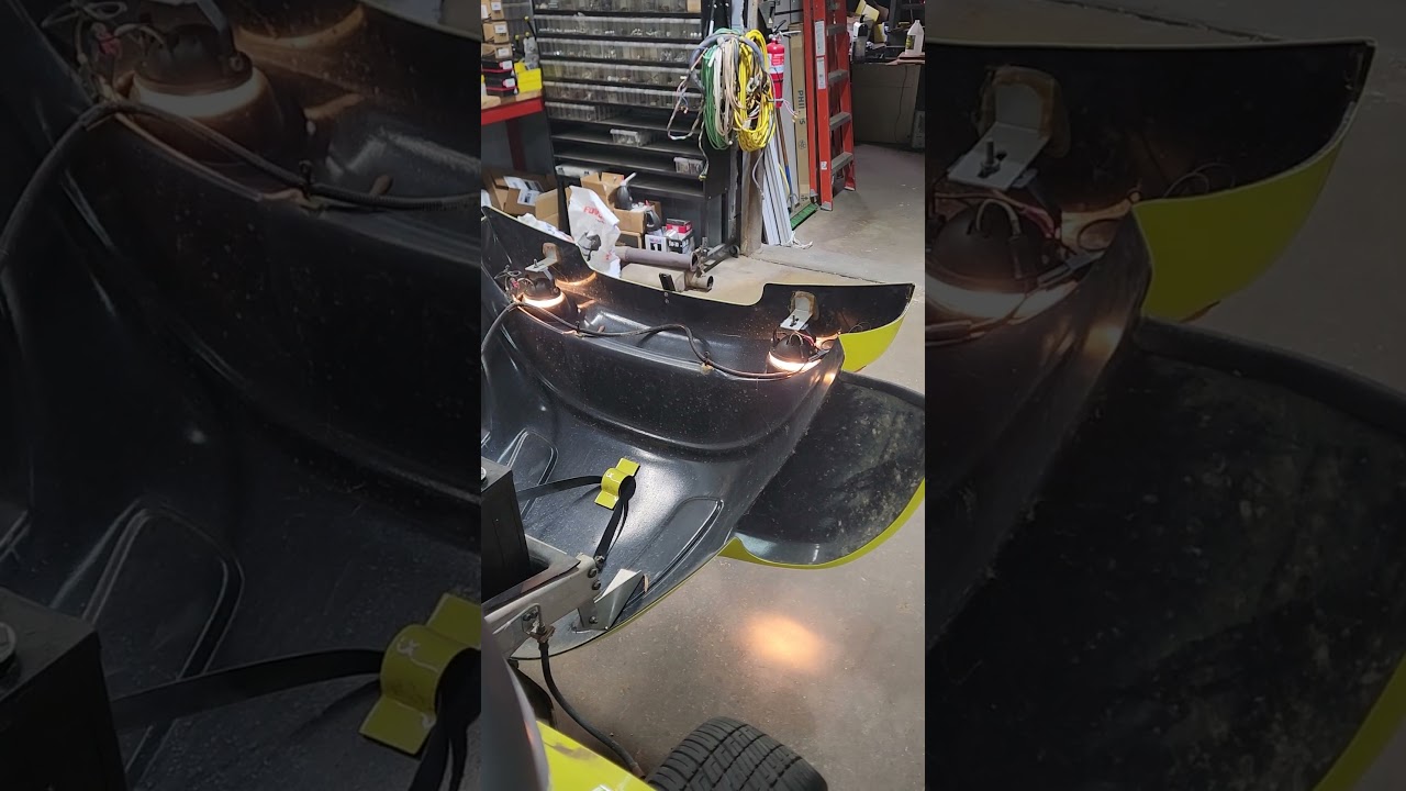

01 E825 NO GO just master click
Ok here’s something else to add i just noticed. In turf mode no beep but when you change to road mode its a loud steady noise from alarm but goes off after solenoid clicks.
parking microswitch. I have a green wire on top, white in middle, and yellow/green on bottom
This sounds correct. Since beep changes with brake state, I’d say this works.
Just to make sure we are both on the same page.
Ref Video (above)
OK, Rev beep, switch looks like it is in REV?
When switched to Fwd- goes to steady beep?
Then you release the brake(either direction), the beep silences, and the code -04 on the dash clears and changes to what? (before MC kicks out).
Then after MC kicks out, Is there still a code? (vid never swings back over there)
I’m at 73.1v pack and @ fuse …solenoid.
Most likely not your problem, but that pack is almost depleted. Charge it up.
Will check those on Monday and get back with result sir.. Thanks for helping me out
